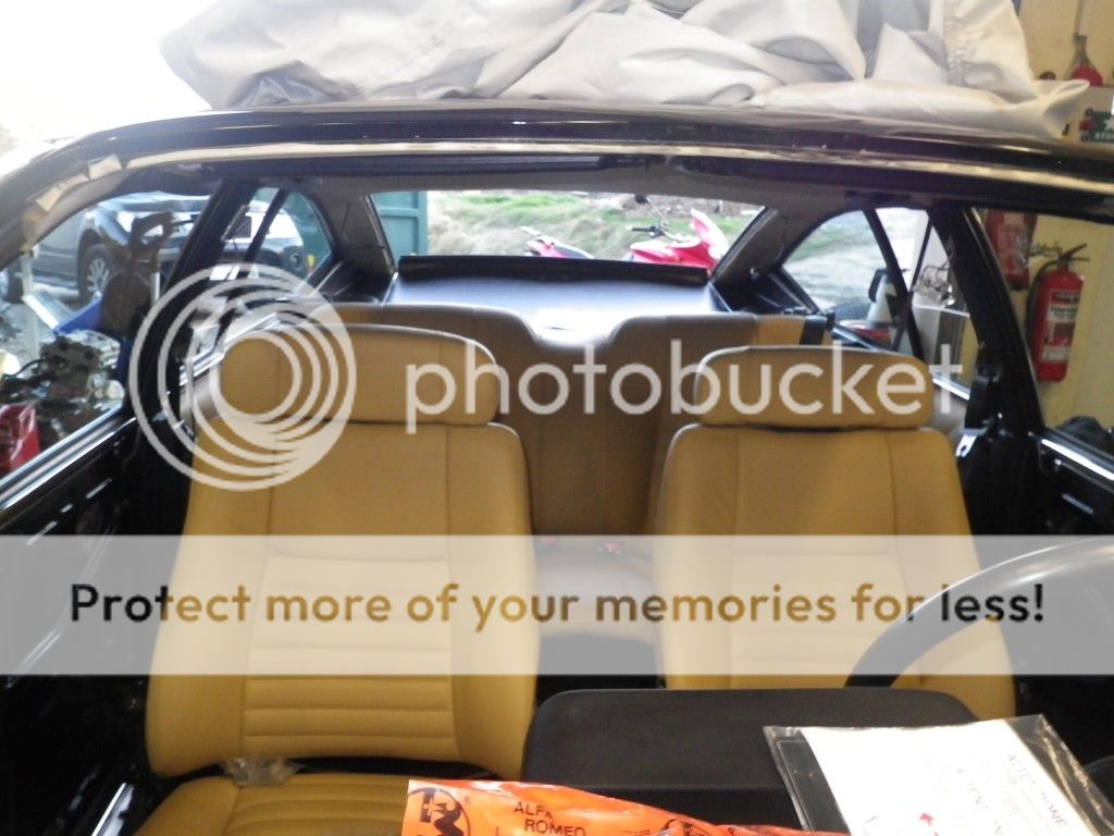

                    Nysydd inredning:
                    [URL=http://s545.photobucket.com/user/hauge/media/Alfa/IMGP0056_zps6025e7b4.jpg.html][/URL]
