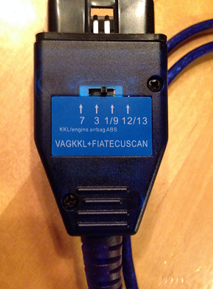

        Sam, I managed to connect to the engine and ABS yesterday but not the airbags.
        This is a picture of my cable, since you build your own, how should I check if the pins are connected correctly? Is it enough to measure with an Ohm meter according to the specs for the different adapters on the multiecuscan page over the pins that should be connected together in the different positions of the switch?
        In position 3 nothing is detected, in pos 7 and 12/13 engine is detected and in pos 1/9 engine and ABS is detected.

          hi, there
          I think better way to do this is by take the case off. check the wire with multimeter. they said for this protocol. you should have
          pin 1 – ABS
          pin 3 – Airbag
          pin 7 – Engine/Gearbox
          pin 9 – EPS
          also people suggest not to put airbag with any other pin together. it is risky.
          or you can send it to me by mail. I can check it for you.

            the label on your cable are very confused.
            12/13 for what ?

                  hi, I think when you check your wire you will see as follow.
                  Airbag is soldered to pin4-5, instead of pin3!
                  ESP is soldered to pin11-12, instead of pin12-13.
                  you should re solder it as follow
                  pin 1 – ABS
                  pin 3 – Airbag
                  pin 9 – EPS
                  pin 12 – XENON
                  if you need all the function.
